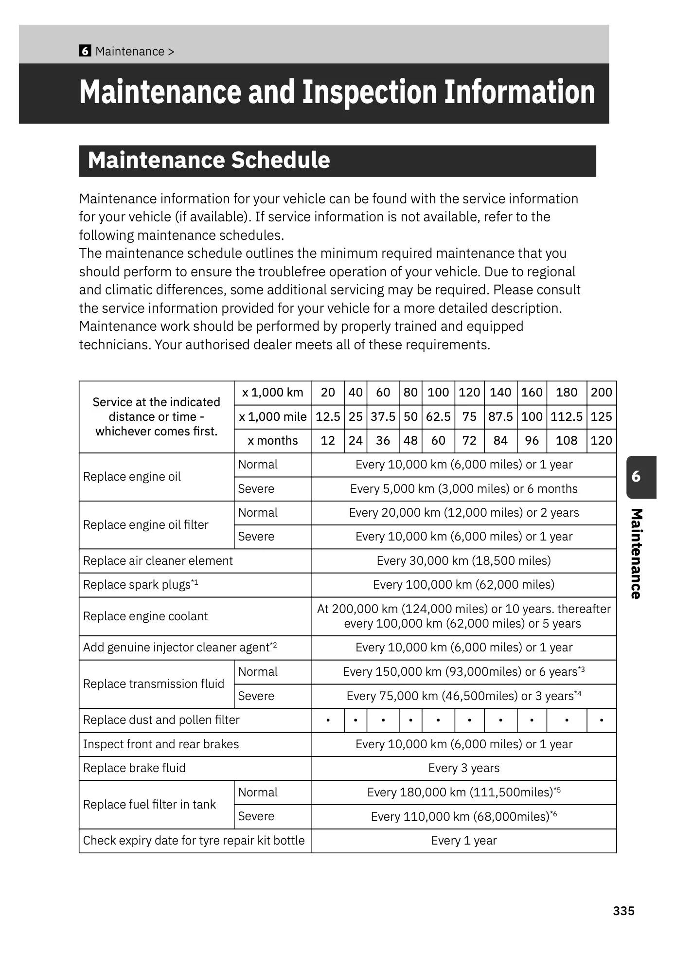

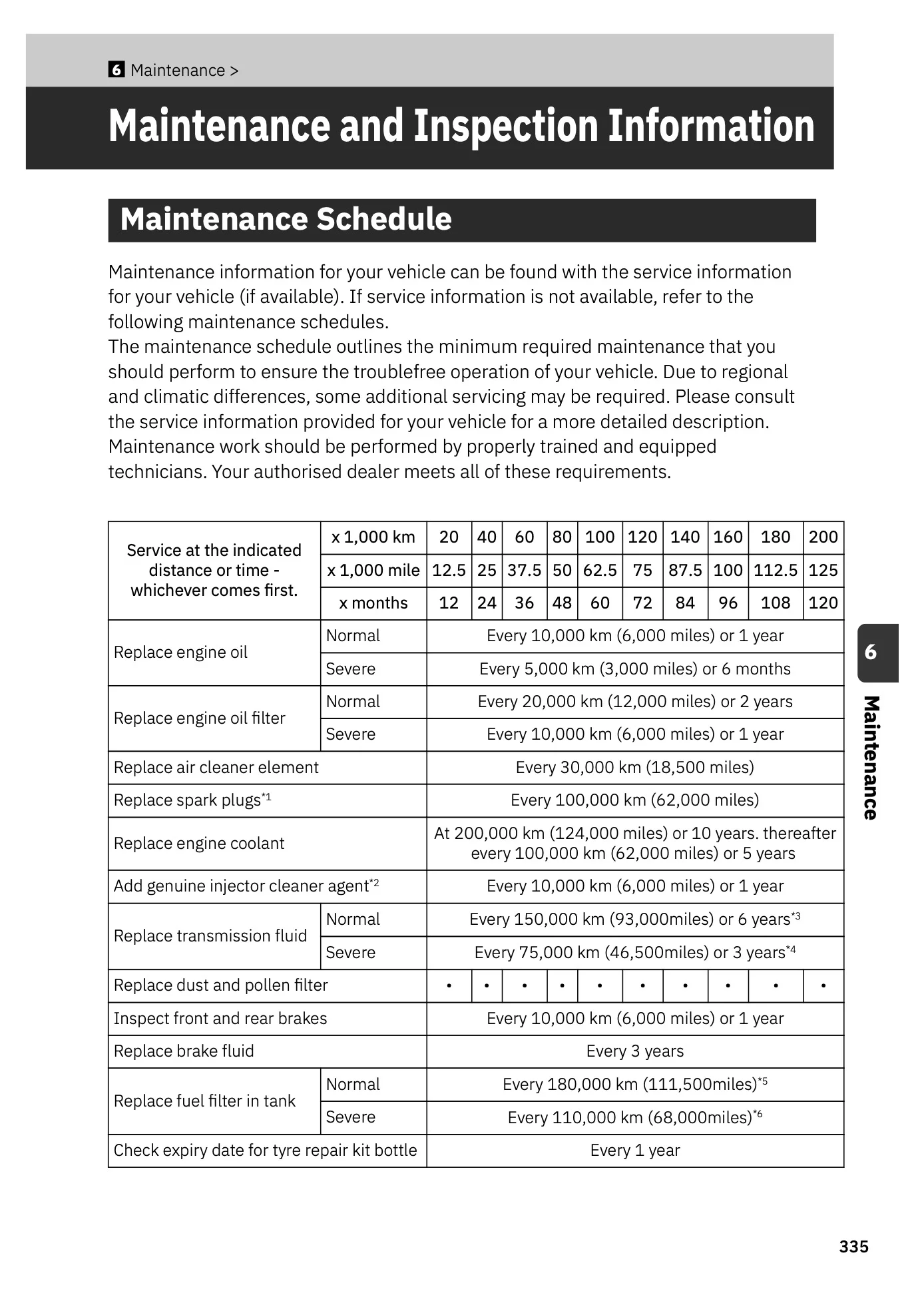

Here's the relevant page from the user manual, setting out the service requirements. I'm glad it's not just me that thinks it's confusing and inconsistent... 🙄
Yeh, that’s the page.
It’s not really ambiguous at all, is it?
Here's my interpretation (yours might be different):
"Your new car should be serviced every 12,500 miles, or every 12 months - whichever comes first. But it will also need an engine oil change every 6,000 miles. There are some other things that routinely need to be done every 6,000 miles too, like checking the brakes and maybe changing the oil filter as well. Turning the page, we'll also need to inspect tie rod ends, steering/boots and suspension every 6,000 miles. Oh, and you should get the tyres rotated at the same time. So the service interval is definitely 12 months/12,500 miles - apart from all these other things that need to be done sooner. If you have a pre-paid service plan, your dealer will probably ignore all the extra stuff at 6,000 miles and might just stick to the 12 months/12,500 mile interval. Of course the Maintenance Minder built in to your new car might say something different, so you could either follow the service schedule that we've set out here (in the official manual that came with your car), or you could follow the Maintenance Minder (although it might not flag up the 'every 6,000 miles' items - you'll' have to wait and see). Alternatively, if you'd rather keep it simple, you could just ignore everything we've said here and instead go along with the 12 months/12,500 miles that your authorised Honda dealer is intending to do under the terms of your service plan ."
All clear now..? :)
I'll eat my shoe if any standard dealer service plan honours that properly and doesn't just stick to the 12.5k/12 months. Of course they should, be they won't.
Moments like this make me glad that I can do my own servicing - as well as getting some (rather random) 'official' servicing done by the dealer if I choose to...🙄
All clear now..? :)
Yes, thanks, you have confirmed my interpretation.
All clear now. 🫡🫠
