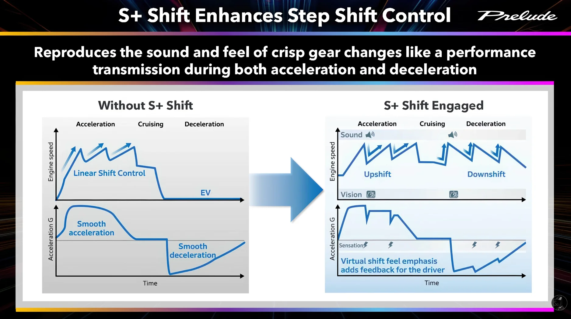

In the lower 'gears' the system also uses more regenerative braking as you ease off the throttle. Driving the car in a spirited way, you can drop down a 'gear' as you start to turn in, and actually feel the front end of the car tuck into the corner a bit more tightly.
Similarly, as you exit the corner and start to open the throttle more, changing up a 'gear' helps to straighten the car's attitude. In this way, the S+ system can create a genuine effect when the car is driven swiftly through a series of bends, by directly influencing the vehicle's rotation/turn-in.

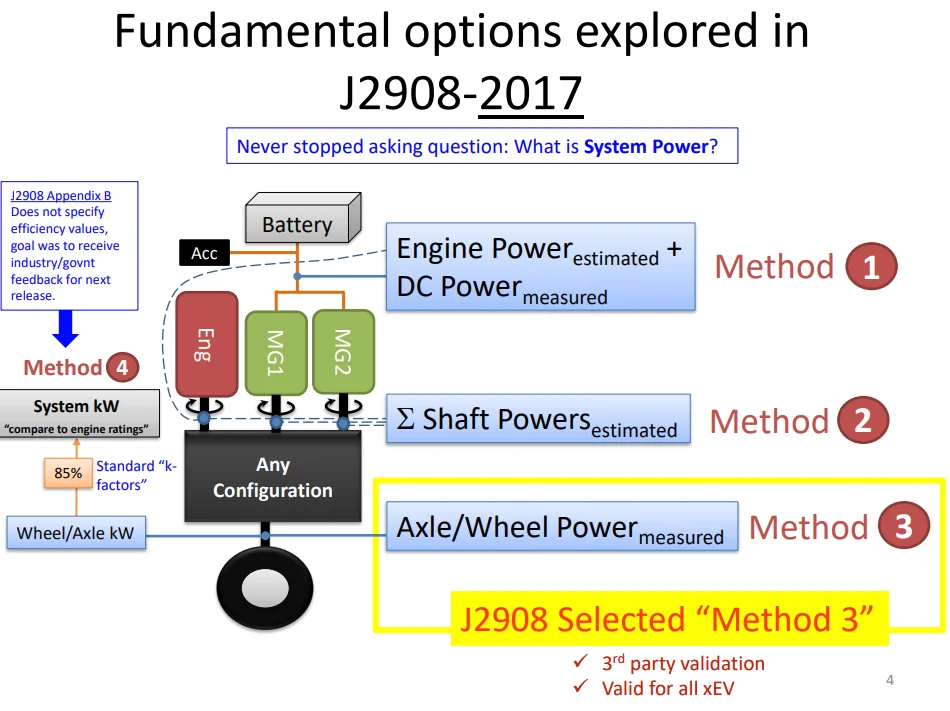

SAE J2908 Vehicle System Power RatingSAE J2908-2023

TLDR: in the US they measure peak mechanical output power of the entire system. Europe measures the peak output of the power source itself.

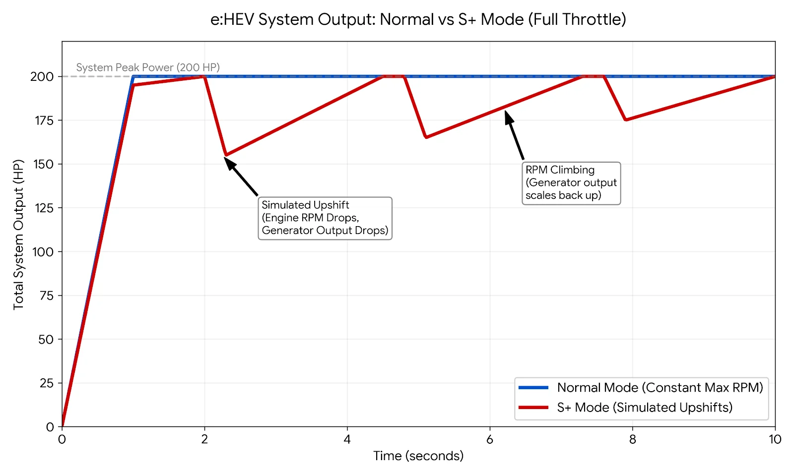

More directly back on topic it isn't actually quite that simple. There's a real mechanical physics reason the car is slower to 60 when rowing through the 'fake' gears in S+ and it's not just because of the brief deliberate delays they put in to simulate the momentary torque drop of a clutch.

So why does that matter to the original point of the thread? Well it means that when you 'upshift' into a higher 'gear' the actual real RPMs of the engine drop, and therefore the current power output of the engine drops, and therefore the power output of the entire system drops. Meaning the growing surge in power you feel as you then climb back through the revs is real and not simulated. The gears are not, but the effect of the revs are real just like they would be in a real gearbox. THAT is why it is slower to 60 in S+, your actual peak power output IS lower during those lower RPM moments due to 'upshifts'. It's also why when you floor it not in S+ the car will sit at max RPM and scream their the entire way, because it has to in order to be able to put the power to the wheels, not to keep the battery topped up. It's also why you can't go more than ~20mph without the engine kicking on even if the battery is full, because the battery physically can't push out enough juice to turn the motor hard enough to get you going any faster.
So yeah @GoZoner's claim of using S+ in order to keep the revs higher to have more power ("It is allowing you to modulate the RPM of the ICE engine to enhance electricity generation and thus acceleration") is correct. I imagine you'll find around a track you will get better performance using S+ than you would without it as you won't be waiting for the engine to be rev'd back up to full power as long as you would without S+. It just doesn't apply in a straight line 0-60 test as at no point are you lifting the throttle which would have allowed the system to severely drop revs in the default mode, whereas around a track you will be letting off the throttle for corners and so want the power ready and waiting for you to mash it out the bend. And yeah a 'boost' button that just held the engine the entire time at peak power RPM would be the fastest option, but damn would it be annoying to listen to.
EDIT: Edited to remove mention of planetary gearset, Honda does not use one and instead has a direct drive clutch only used for cruising. The reality is the Prelude actually cannot ever put 200hp 'to the wheels'. So the opposite is actually true for the whole Europe vs North America power figures, the real true power of the car is 184hp, not 200hp. The 200hp figure is just the mathmatical peak of the engine's output plus the batteries output, not the peak amount of power possible to output to the wheels.

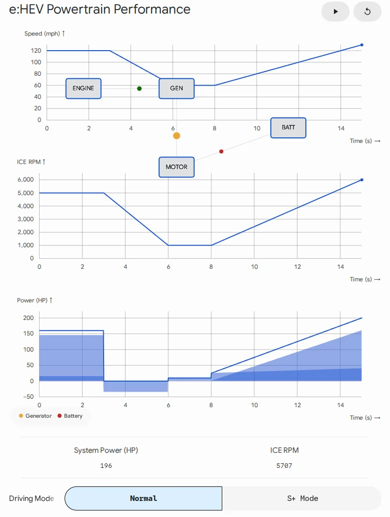

Here's a little chart helping to visualise what's going on during a straight line full throttle pull:

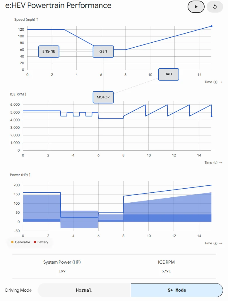

I also charted a little simulation help. Ignore the exact numbers and just look at the shape of the graphs. This simulates approaching a corner at speed, lifting off the throttle, then accelerating back out of the corner.
Here in non-S+ you can see the revs drop dramatically, then climb back up as you accelerate. Dropping total power to almost 0hp right as we hit the throttle to accelerate back out of the corner.
In contrast, in S+ mode you can see the backing off of the throttle, but then downshifting to keep RPM high, so the total power available is notably higher at the moment we get back on the gas to power out of the corner letting you command almost all of the total power of the car instantaneously. In the real world this results in exactly what Honda promised, a more responsive and enjoyable drive.
