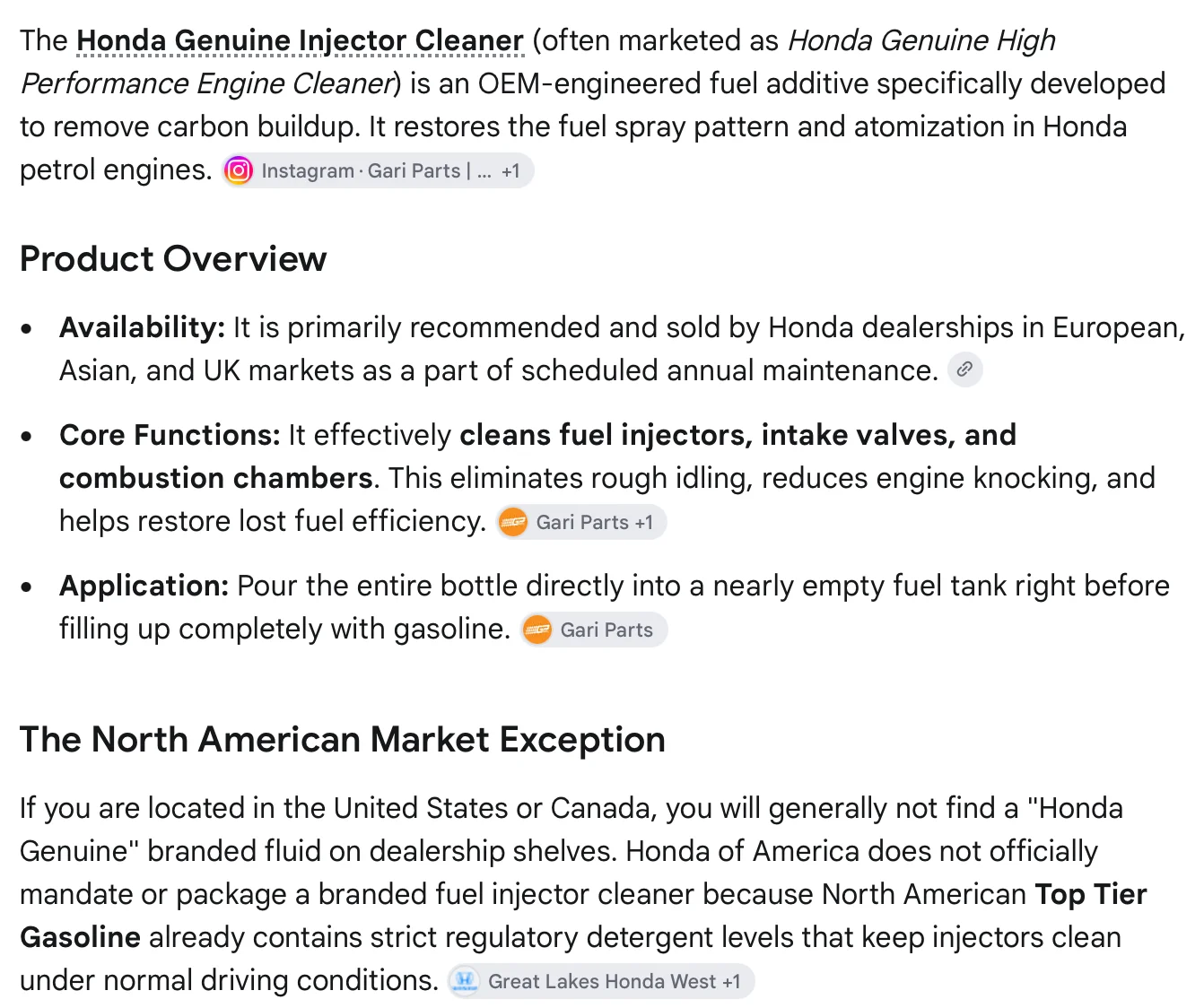

The maintenance schedule posted here shows 'add genuine injector cleaner agent' every 10,000 km / 6,000 mi. That maintenance schedule is shown in the UK owner's manual; there is no corresponding schedule in the US owner's manual. I looked up 'honda genuine injector cleaner agent' figuring if I'm doing my own maintenance, maybe I should add some. The result was "not needed on North American Hondas". Here is the search/GoogleAI result:

Use Top Tier gasoline and you won't have an issue. I run nothing but Top Tier in my cars but just using it every few fill ups will help.

Honda's injector cleaner is a high-detergent polyetheramine (PEA) and other excellent (and safe) PEA products are available too: the ones with the highest PEA concentration include Red Line SI-1 and BG 44K. Personally, I have used Red Line SI-1 for well over 20 years and have never had an issue with the fuel system on any of my cars.
Be careful about what you add to your gas/petrol. Some fuel system 'cleaners' contain toluene, xylene and even acetone - all of which can harm rubber components and O-ring seals in the fuel tank and pump.
Cleaners or premium fuel are probably a reasonable idea as on occasional treat for the injectors but don't bother otherwise. It's a direct injection Atkinson engine so race fuel and ultra-mega-super additive beyond that isn't going to do anything because the ECU just won't care, and you can't prevent carbon buildup because of it being direct injector.

I'm not so sure about that here in the States. Top Tier is the way to go since it doesn't cost a penny more and has proven advantages. If I can get something that has been tested and certified not to contain dog crap why would I spend the same money for potential dog crap?

Top Tier gas is pretty widespread here. Most of the local convenience stores sell all Top Tier. Most of major brands as well. Even Costco sells all Top Tier.
