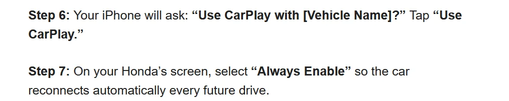

Every time I get in my car, I have to connect my phone manually to CarPlay. Is there a way for me to have my Prelude automatically connect to CarPlay whenever I get in the car with my phone?
...there seems to be a checkbox "always connect" when first connecting the phone ....at least according to this guide
the guide is not explicit for Prelude, but the infotainment ist the same (old :( ) as for Civic XI
but can't test - no apple device here ....
That should fix the issue. Works flawlessly with my iPhone SE. (Remember that you need to have Siri enabled/active to be able to use Car Play.)
