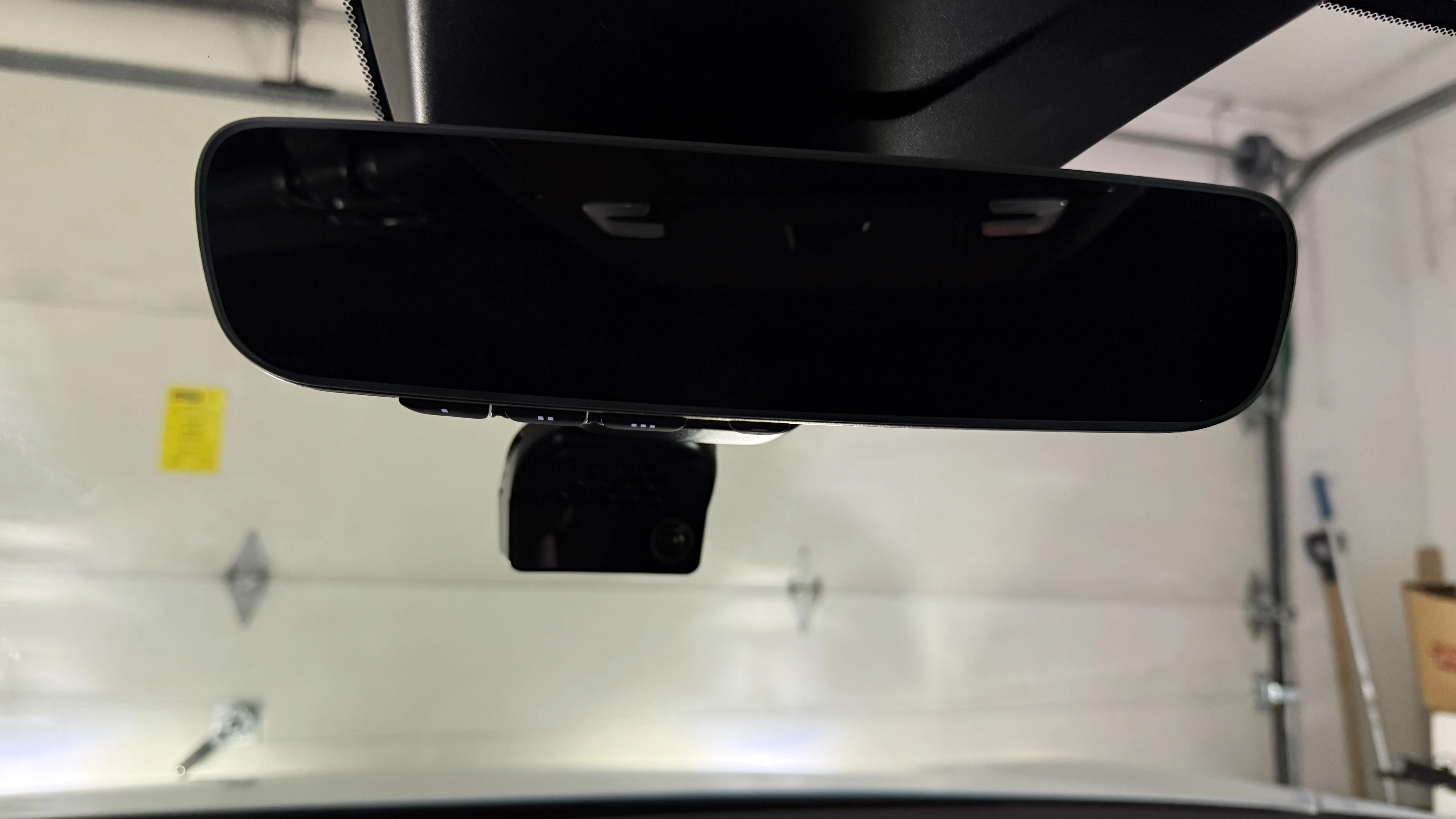

Hello everyone,
I can confirm that the OEM Honda Accord HomeLink mirror retrofit is fully compatible with the 2026 Honda Prelude.
Parts required:
  • Automatic Day/Night Mirror Kit (P/N 08V03-3A0-100)
  • Attachment Kit (P/N 08V03-30A-100)
The mirror kit is available here:
College Hills Honda – Day/Night HomeLink Mirror Kit
When ordering, make sure to also select "2023–2026 Accord Attachment Kit ($44.90)", as it is required for the Prelude as well. The mirror alone is not sufficient.
Accord installation manual:
2023–2026 Accord HomeLink Mirror Installation Instructions (PDF)
The installation is virtually identical to the Accord.
  • Wiring harness is identical.
  • Cable length is correct.
  • The fuse specified in the Accord installation manual is correct.
  • Mirror mounting and headliner disassembly are the same.
The only difference I found is Step 7:
  • On the Accord, the left sun visor holder is released by pressing the locking tab with a small screwdriver.
  • On the Prelude, it uses the traditional Honda quarter-turn retainer. Simply rotate the visor holder about 90° and pull it out.
No other modifications are required.
(Photo of the installed mirror)
