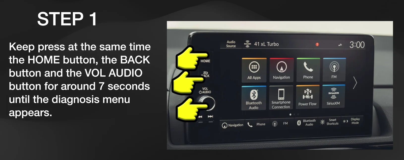

Anyone manage to get Android Auto wireless? Appears to be a given that Android Auto has to be wired.
However, just seen a YouTube post by a Brit who managed to press the Home/Back/Volume buttons on the display simultaneously to reach a whole new world of Default Information Settings. In here, he managed to switch Android Auto from wired to Wireless. I've tried pressing all combinations of Home/Back/Volume but cannot get into the parallel universe where I can change the settings.

Yeah that video isn't great in that you can't really see what he's actually pressing. This video is for the same system and shows you how to get to those menus, should work.

Finally managed to get to that special screen to switch wireless A/ auto on.
Found another video and it isn't the back button between HOME and VOLUME.
It is the << track back button below.
I pressed HOME << VOLUME at the same time for about 10 seconds and the screen came on. I could then switch on wireless android auto - Usb/wireless.
My music played from phone (possibly did any way) but still can't figure out how to get waze on the main screen without plugging it in. I'm ok with plugging it in as it charges anyway.
